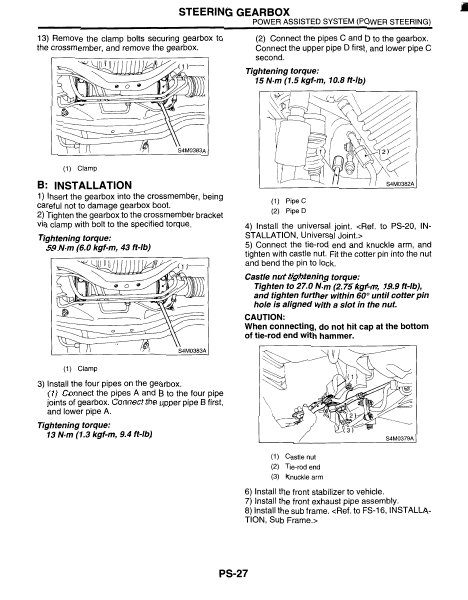

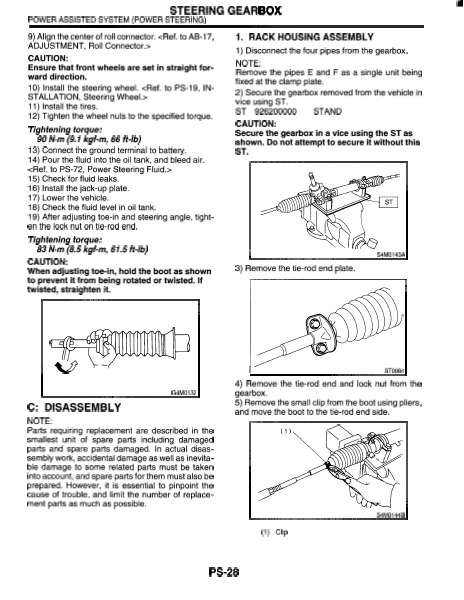

I looked at several repair manuals and it looks like it's only 4 bolts that holds it in place
the sti looks the same
can someone double check for me?

Those bolts hold the rack to the chassis but there are also the power steering fluid lines, the steering shaft, and the attachment to the (edit) tie rods. The steering shaft is easily disconnected by one nut and the rack assembly will slide off the splined end of the shaft but I've never really taken a good look at the power steering lines.
0==WW==0
Attached Thumbnails 04 Steering Rack Question-steering_rack_removal_01.gif   04 Steering Rack Question-steering_rack_removal_02.gif   04 Steering Rack Question-steering_rack_removal_03.gif

i have the exact same manuals. it looks like it has the same lines as the sti
im assuming that 02/03 are the same as the 04. hopefully
thanks wingless wonder
the subchassis is going to be fun removing
