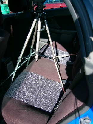

when i got home this morning...
I had a little creative energy, so... here's what i dun made:

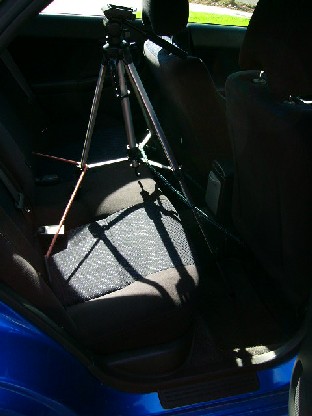

one more
all i did was use two bungee cords. the rear one hooks on to the two outside kiddie seat hooks, and the front one hooks onto the inside seat mount (make sure you hook it around the metal inside, not just the plastic cover) so you have a nice inside mount for:
$12.99 tripod
$.99 x 2 bungee cords
the only thing that didn't work out too well, is that I couldn't get it low enough to look out under the rearview, and during a bright day, you can't really make out the gauges. I did take a short vid this morning, and it came out pretty cool, you gotta have the radio off and the windows up, and then you can hear the sound of the bypass valve, and the exhaust.
