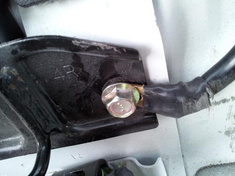

This is where the amps were grounded. I think I need to find a new ground point because both surfaces are painted. Thoughts or suggestions?

I learned the long way that what you're showing is NOT an effective ground. As others have already said it needs to be on UNPAINTED metal.
So you could still bolt it to the same place as shown. Just remove that black plate and get some sandpaper right near the bolthole. Sand it down to bare metal. Attach the grounds and then the metal bracket on top (hope it fits)
Did that and hooked everything back up. Gonna test it out over the weekend.
