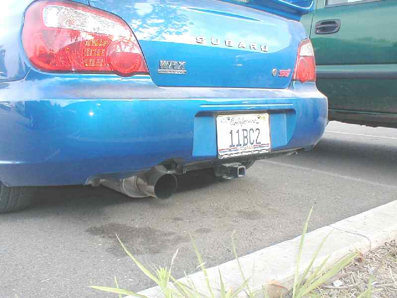

Here's two pictures showing my receiver.
I apologize for the one picture; I'm at work & my co-worker "helped" me out.
Attached Thumbnails Who has a trailer hitch on their 02+ Impreza sedan?-pauls.jpg   Who has a trailer hitch on their 02+ Impreza sedan?-bad-paul.jpg
Bwahahaha!!! That rules! We really need to get Oaf's pc skillz up to par! Wait, then we wouldn't get stuff like this anymore, nevermind!

Oh, that's great! You are a good sport Oaf! Thank you for your info - so that's yet a THIRD rack that's availble! Sheesh!
