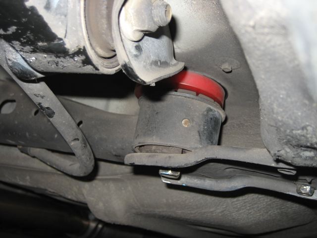

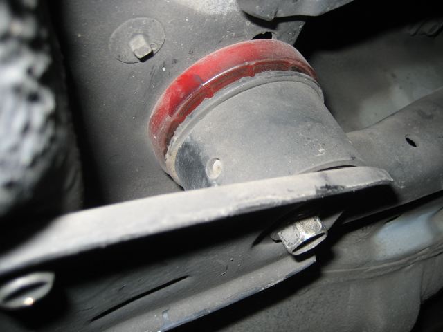

I would like to look at your rear end seriously I have an issue with my rear diff swap and would like to take a peek under a stock rear end.Please pm me and ill come to you! thanks mike
here is my issue!
Attached Thumbnails sacramento foresters need your help..-img_2462.jpg   sacramento foresters need your help..-img_2463.jpg   sacramento foresters need your help..-img_2461.jpg

Looks like the subframe wasn't reinstalled properly.
How did the installer go about R&R'ing the diff?
--- Undo the bolts for the diff, remove axles, pull diff?
or
--- Pull the entire subframe, put it on the ground and then go at it?
Looks like option 2 happened. Shouldn't be too much of a fix.

subframe never came out? just the diff...
