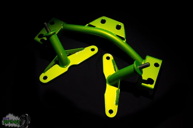

Update #22:
This is where the car stands as of today (3/27/14)
What's up everyone? Well currently my car is pushed out of the shop so my fabricator could make some quick cash building some cages. In the meantime while I'm waiting I've decided to share my finished mount kit and my finished FLCA's. These FLCA's are available for purchase ($700 raw metal or $800 with powder coat of your choice) They push the ball joint 1" out and 1"forward in comparison with the STi Aluminum Arms. They also only weigh 1-2lbs heavier than the aluminum arms. The FLCA we built uses a 95 (GC) style ball joint that you can purchase virtually anywhere. I decided to use Moog's. The FLCA them selves are made of cold rolled 1018 steel. If you're interested in purchasing please PM me here or email us at info@teamburnthemost.com

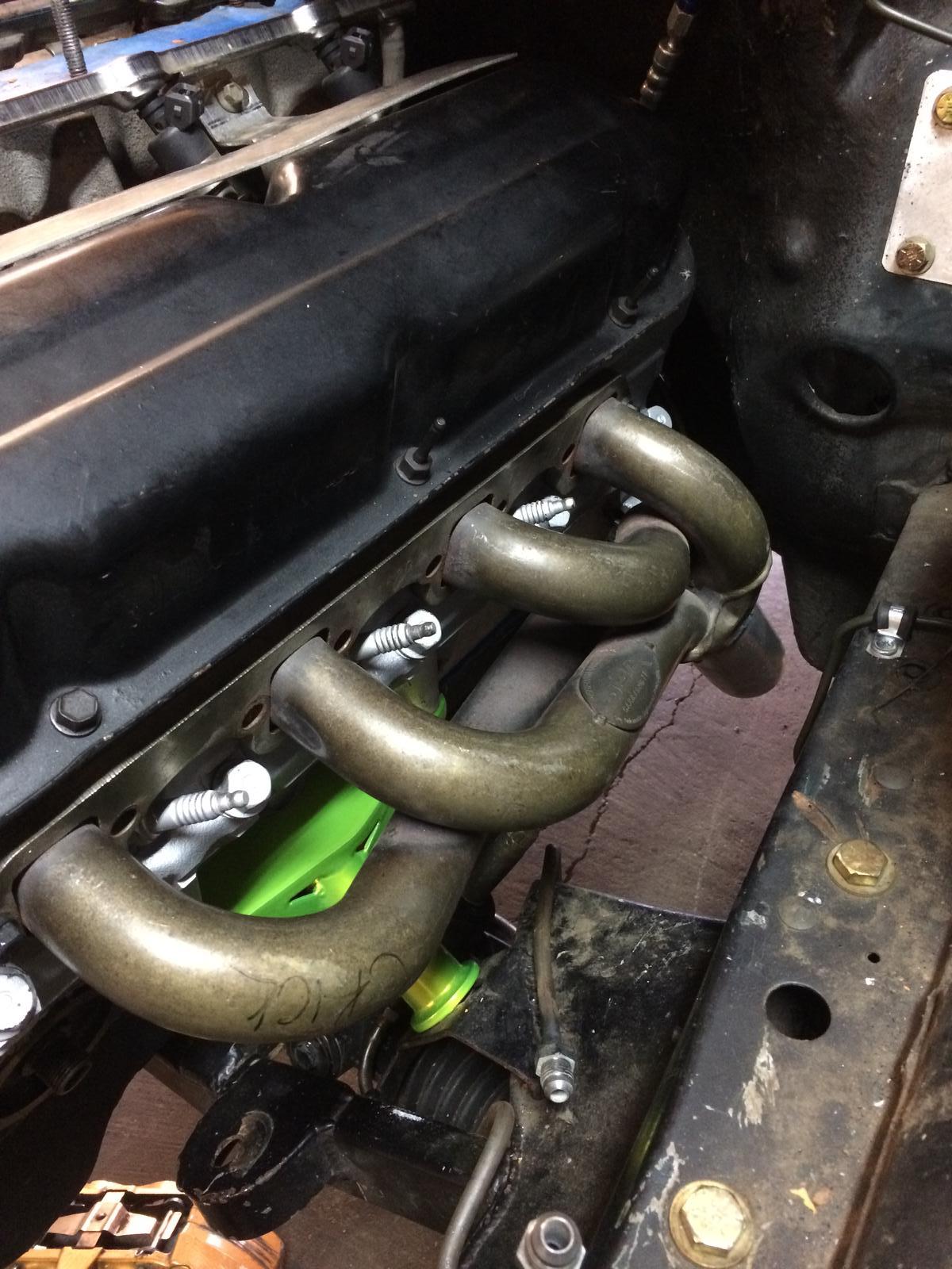

Yesterday we started/finished the exhaust. Surprisingly there was no needed fabrication done to the JBA Firecones which made things super simple. I don't have the picture of the finished exhaust but here are some parts tac'd in the car.
