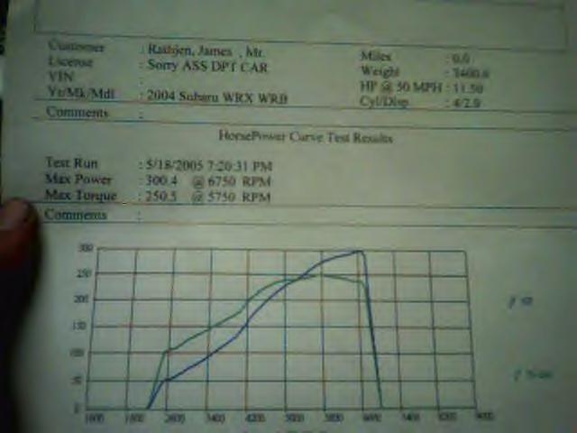

well finally got off my lazy **** and installed them today, went smoothly, i got the CEL of course but my car DID NOT go into limp mode like aaron had stated, car feels stronger from 5000 rpm till redline, wed i will retune i will have a baseline before he retunes it to compare from the runs i put down a couple weeks ago, just an fyi my tuner Mike from gruppe-s tuning recived the tgv cel fix from ecutek this morning so it came at perfect timing, heres what i dynoed before on CA 91
car is an 04 wrx sedan with a gt30 turbo kit, at 1.3 bar of boost, and supporting mods

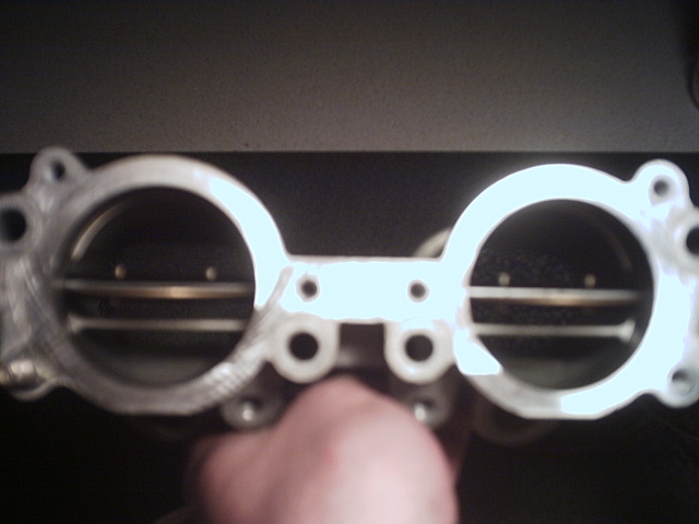

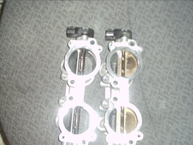

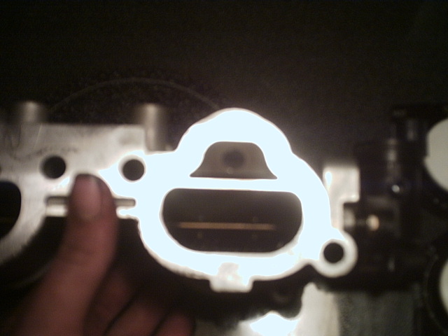

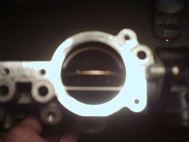

here is the stock TGV's for noobs, u can see theres a pile of crap in the middle of your intake system
