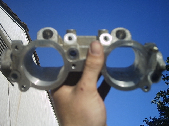

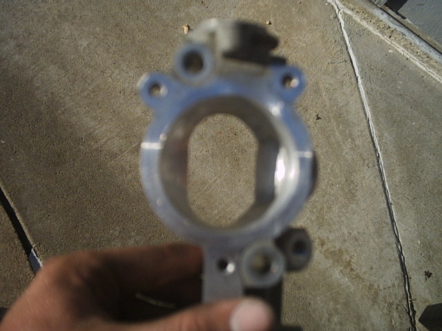

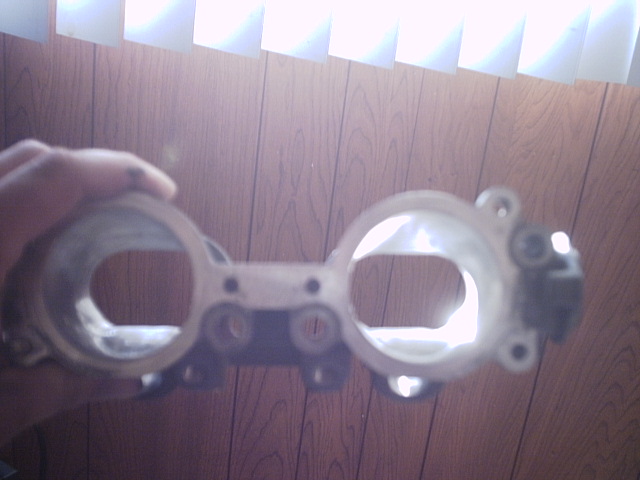

finished these the other night thought id post em up gonna instal and retune the car this week or next
Attached Thumbnails My TGV deletes-tgvs-009.jpg   My TGV deletes-tgvs-005.jpg   My TGV deletes-tgvs2-003.jpg

Are those the stock housings?
If so, how did you remove the rod?

these i belive are spec-c tgv's??? or some sort of jdm tgv, there is no rod and the housings on the ends are filled, i have done a set of usdm tho, to get the rod out u need to unscrew the butterflys or what i do is just drill them out once u slide those out, take off the sensor and pop it off, theres some plastic material and a metal washer on the end take a grinder and grind that off hit the rob with a punch and it will drop out the other side, after that u need to have the holes filled on the insides of the tgv where the road was removed, u might be able to get away with using some sort of expoxy, i would have them welded up and port match the chambers
