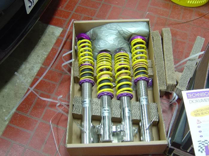

The KW's finally showed up. Now I need to mount the Cusco front camber plates and GroupN rears.
They'll be going in along with new lateral links, new trailing arms, and Whiteline diff lock bolts - just in time for my next track day.

Originally Posted by laoba
any impressions on the KW's? are they too stiff for street?
My KW's are 9kg front and 8kg rear and I thought they would be way too stiff for the street. In fact, they are just fine. I turned the compression down from 7 of 8 turns to 4/8 and they are quite plush - I was pleasantly surprised. These are stiffer and more accurate on the track than the JIC's I had on my WRX AND they are much more comfortable on the street than the JIC's.
All in all, I am very happy with this purchase. I need to get some of the install pics out of the camera for the KW's and the Poltec rear setup. I'll post them soon.

Originally Posted by silentbob343
What exactly do you mean by that? After a certain amount of use things wear out and will need to be replaced/rebuilt.
JIC's and other coilovers need to be rebuilt every season. The KW's do not.
