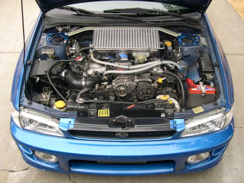

I am getting very close to being ready for tuning. Just changed my oil and got this stuff just chilin waiting to be installed for the tune..
Ebay TMIC
Colder plugs
Cobb AP
Once I get this issue figured out I'll get tuned asap: https://www.i-club.com/forums/engine-management-66/car-wont-boost-now-any-ideas-140361/

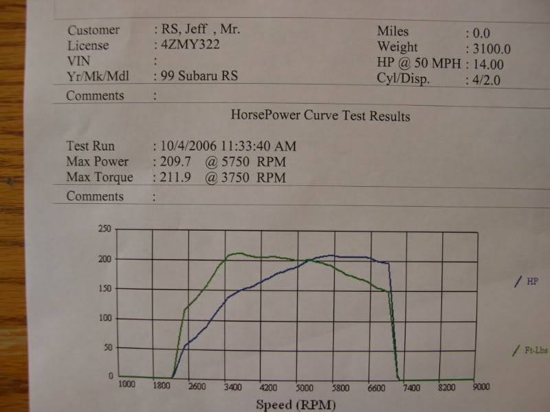

Recieved the protune treatment today here's the results...
...needless to say its a quick little sob now. Very happy with the new useable power!! Time to drive and enjoy
And da money shot...
