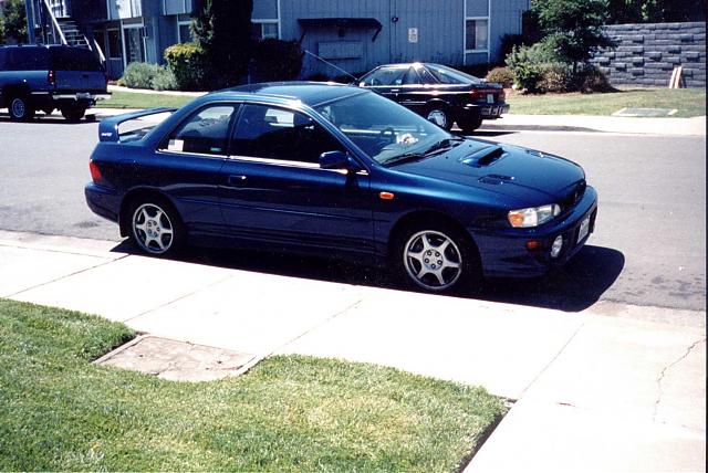

Here's where I started:
Plain ol' stock 2001 RS, bought new in Oct 2000. At the time I knew nothing about i-club, autocross, or that they let regular people drive on racetracks. Complete and total n00b... I thought that the stock RS had great suspension and RE92s must be great tires, since they put them on such a fast car.
I started teaching myself to drive by just going faster and faster around backroads near Vacaville and Lake Berryessa.
Eventually, I discovered aftermarket parts on eBay, and places like Cobb and JC Sports and Minnam Racing. Started making plans for a turbo kit...
When I got involved with autocross and i-club in fall of 2002, the car was still stock, down to the near-bald RE92s. My first mods were a cheap shifter and strut tower brace, and a 20mm FHI rear sway bar. That one mod still made a bigger difference in the car than any other to date except tires. That was the next mod, 205/50R16 Potenza S-03s. Still my favorite tire ever.

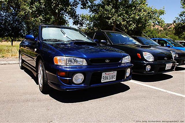

Fast forward to June 2003, at the annual Mt. Hamilton meet:
By that time I had added Prodrive World Rally suspension to the mix, along with STi front strut mounts. Also had added the black i-badge and clear repeater lenses. Cheap, subtle, and look good IMO. I think I also had my Borla headers by then. Added a bit of power with my snorkelectomy, but sound like crap without a good catback. Make sure you have a new muffler before doing single-wall tubular headers kids.

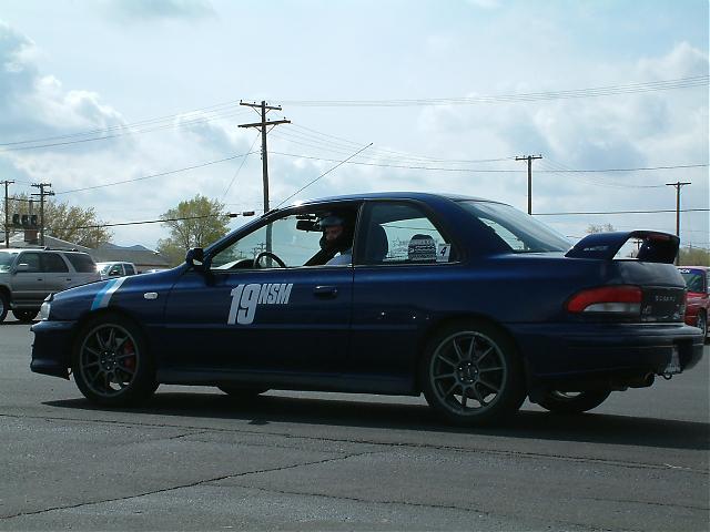

Fast forward again to the end of last year. I was going to every autocross and trackday I could by this time, and had done most of the mods possible on an NA RS.
The car as it is at the moment:
Turn:
Prodrive World Rally Sport struts/springs
STi Group N strut tops
Whiteline 20-24mm adjustable RSB
Whiteline heavy duty sway bar mounts
Whiteline front solid aluminum endlinks
Whiteline rear solid aluminum endlinks
Whiteline diff bushings
Whiteline rear strut brace
STi Carbon Fiber front strut brace
Rear camber bolts
Goofy *** autocross alignment
17x8.5 Volk CE28s with 235/40R17 Bridgestone S03s
Gold '98 RS wheels with Dunlop WinterSport M2s
