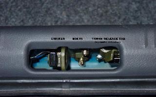

Sorry about image size... What I tryed to show is the striker and the lever that moves to the right to press against the trunk actuator when the remote release is pulled.
Also there is an image of the striker bolts from inside the trunk. In the original you can see the imprint of the bolt and how far it had to be moved. Make sure you adjust up only slightly as side movement will degrade remote release function.

I'm going to have available the original quality image to PM if required with arrows, etc which can't be seen in the images here.
