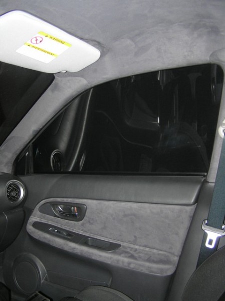

Suede interior....

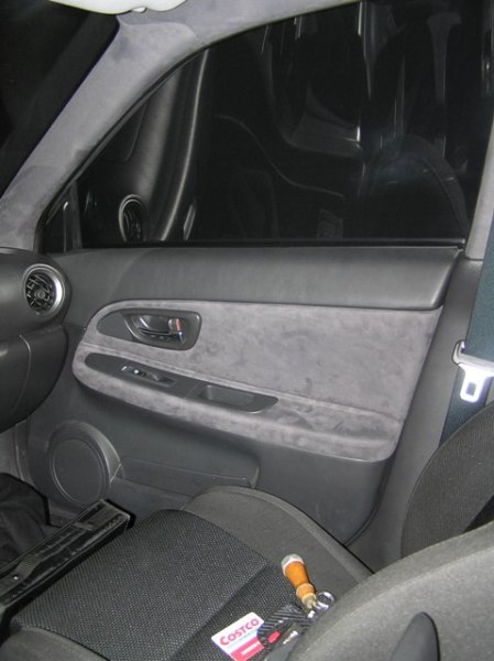

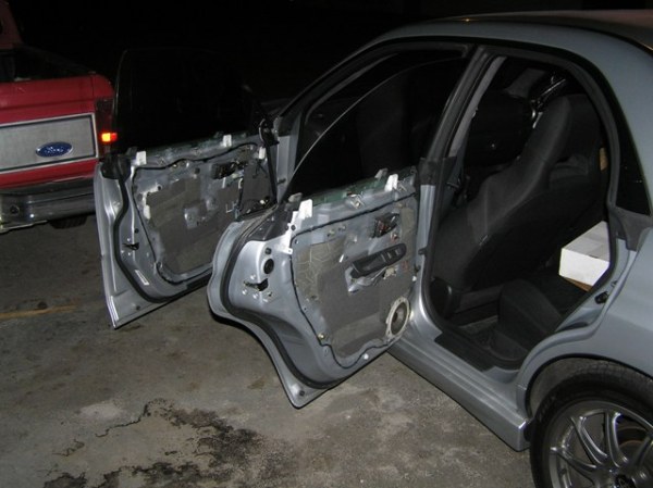

more pics added, finished the door panels over the weekend
Attached Thumbnails Suede interior....-doorpanel1.jpg   Suede interior....-doorpanel2.jpg   Suede interior....-doorpanel3.jpg   Suede interior....-doorpanel4.jpg

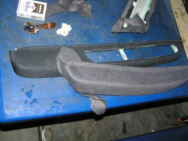

The door inserts were a major biotch, me and my buddy decided to take apart the arm rest/window control part instead of trying to wrap them in place.....but, the problem is the abd plastic studs they use to attach those parts to the door panel have to be drilled out and then in reassembly have to be soddered back in place.....but, they don't always fit back because those parts had to be double wrapped to avoid seeing the waffle texture of the stock fabric. <-----if you use high quality thicker suede this problem can probably be avoided, or you can strip the stock fabric and refoam the arm rests, this is actually the correct way to do it, i was just too lazy to.
