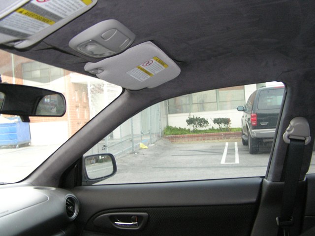

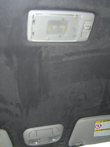

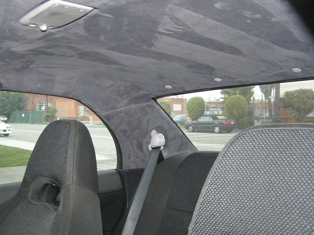

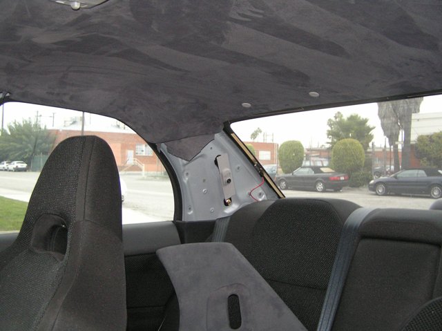

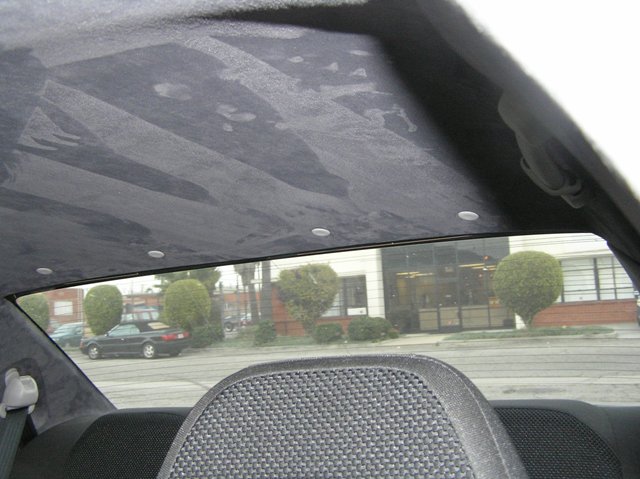

I couldn't take the plastic A pillars, etc and paper headliner anymore.
Total cost of project=$50
suede-$8/yd x 5yds
contact cement-$5
sand paper-$5
Attached Thumbnails Suede interior....-web1.jpg   Suede interior....-web2.jpg   Suede interior....-web3.jpg   Suede interior....-web4.jpg   Suede interior....-web6.jpg

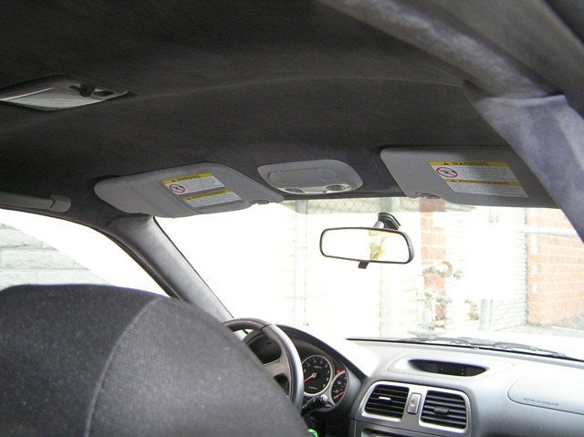

I think I like it! Did you completely remove everything or just cover it up? Now you just need to do something about those sun visors.

^^teh sun visors i'm gonna have to take to someone to get wrapped, they need to be stitched and I'm no seamstress!
Next i'm gonna wrap the door inserts, I don't really like the wannabe carbon fiber fabric.
Yeah I pulled everything out of the car, I'll post some pics of the pieces out of car and how they get wrapped.

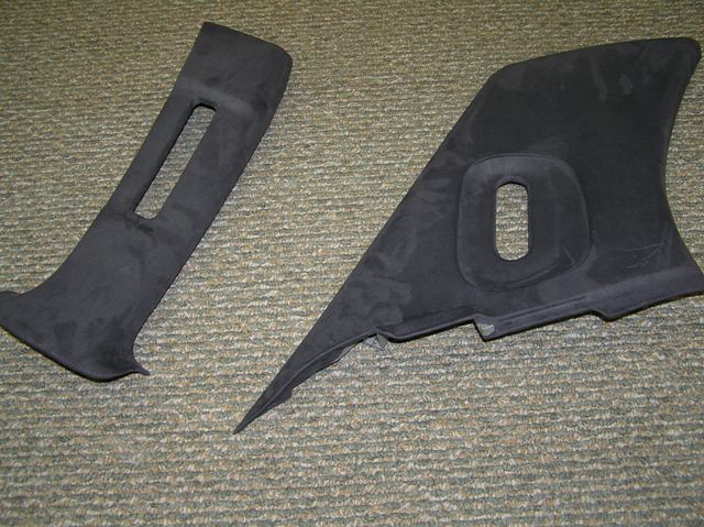

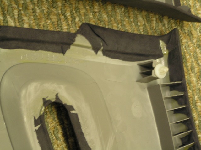

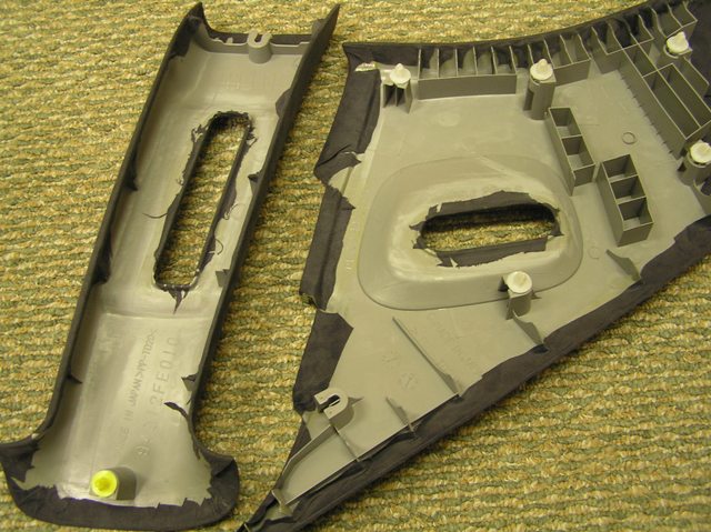

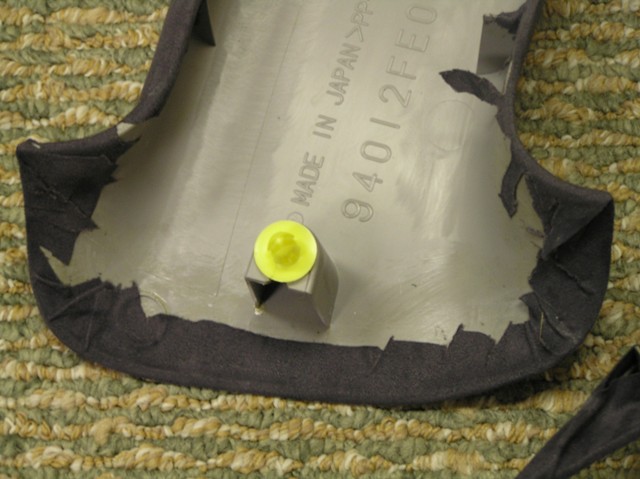

Here are some pics of the interior pieces out of the car.
The job itself was pretty easy, but you need a compressor and a spray gun to spray the contact cement.
And if you do the head liner, you'll need a buddy to help, extra pair of hands is needed for the large piece, and the head liner was a little tricky getting out of the car, finally got it out the passenger side front door with a little prodding and prying.

^^you can use 3m adhesive in a spray can($8/can), but it doesn't stick as well as the contact cement.....you spray the cement on the plastic piece and then spray the suede and let both dry, then the contact cement really grips well
Dunnojack-I would be willing to advise people on how to do it, but i'm no pro when it comes to disassembling interiors, some clips get broken/lost and getting the headliner out of the car is a pain in the *** without damaging some of the corners a little. Its basically an arts and crafts type project and this was the first time I attempted to tackle it myself, so you live and learn as you go.
I bought a $29 detail spray gun from Lowes to spray the contact cement, I have access to a compressor at work, so 29 bucks for a spray gun and try to find a friend with a compressor.
