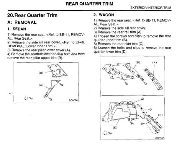

alittle picture to aid
for the 02 but probably the same.

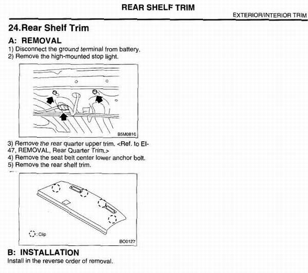

the rear deck half
