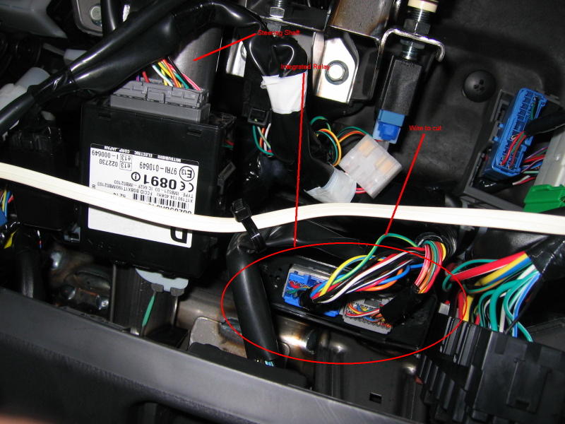

Old May 23, 2008 | 03:42 AM
Ballz's Avatar
iTrader: (44)
Posts: 6,133
From: Palo Alto, Ca
I have an 07' STI, and here is what I did, but I didn't cut the wire. I just pulled the pin out of the blue connector and put some shrink tubing on the pin so I don't void my warranty. This plug is right under your dash on the driver's side. Use a jeweler's screw driver to push the pin out of the plug... Green/yellow stripe wire.. I hope this helps everyone that wants to disable their 07' STI DRL's.
