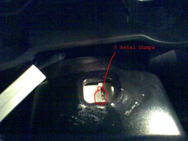

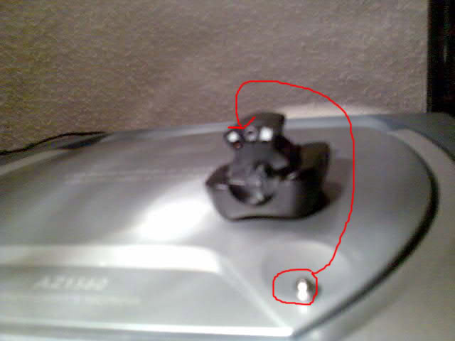

so i finally fixed it due to some stupid mistake.
dont be a retard like me and decide to take out your parking light switch. i thought i never needed to switch my parking lights on and off so i decided to take that out, but infact if you take the parking light switch out it also disables your parking lights (aka running lights).
make sure when you do break off your parking light switch, dont lose that small ballberring. that ballberring is used to push both the metal connections together. i was able to just snap back on my parking light and now its back to normal.
