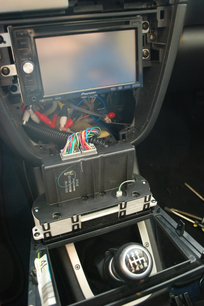

1-Pull out the cup holder, and remove the two phillips screws (do yourself a favor and use a magnetic screwdriver). Dont drop the cup holder screws, lol, I did and almost lost it in the car.
2-Pop out the radio bezel and you will see two plugs that go to the back of the HVAC controls, remove them. You will see the 4 phillips head plastic lights and they are just a little 1/4 turn to remove.
3-Put in your new ones and enjoy.

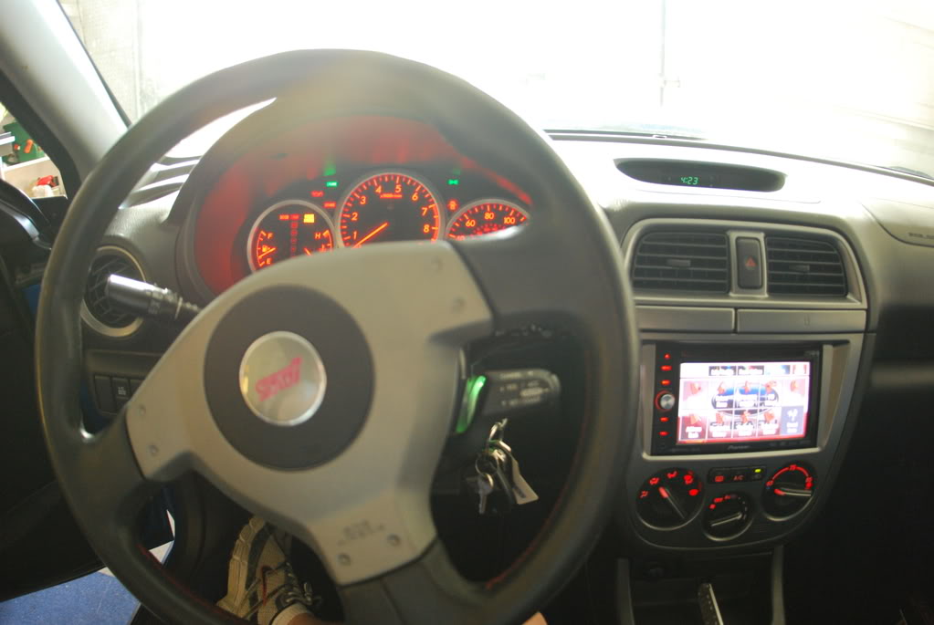

Only bad thing was one of the 4 LED's was faulty. I tried to swap it out in different spots but I geuss it just didn't work, I'll e-mail the seller and try to get it worked out. Here are some after pics, enjoy.

Size:  97.1 KBDash apart, it helps to unplug the harness so you can shake out the old lights upside down.

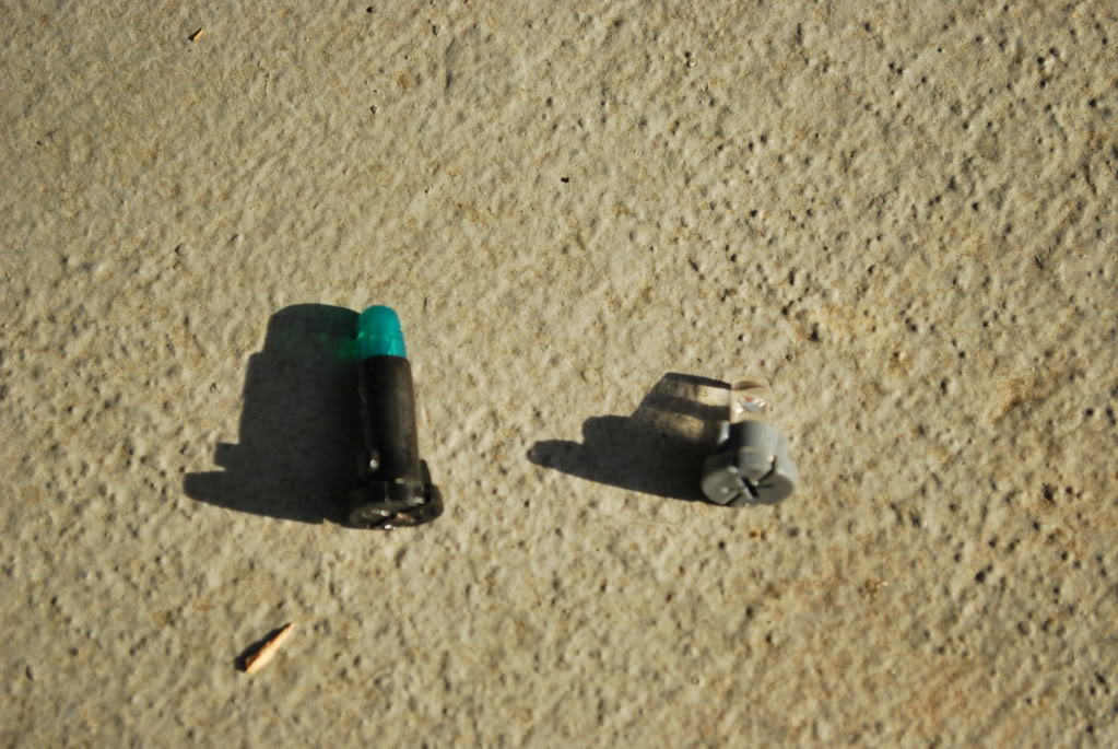

Size:  160.6 KBThe two bulbs in comparison.

Size:  92.6 KBUp close after, you can tell that one od the middle ones aren't working. Check out my cool Subaru navi background
Size:  93.4 KBFar away, so you can see the gauge cluster. And you can tell it matches very well.
