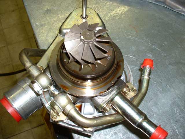

Pics sent to me by Kirk @ PCE:
Note oil past the turbo on the hot side. NOT GOOD.

hey Richard, you're not going to have any machining done to that??
did you already get a rebuild kit?

Car Info: Turncoat Turbo
They're trying to source a rebuild kit right now. I don't even think the turbo needs rebuilding - it just needs a new seal.
They'll know if the land was machined incorrectly once they take the old seal out and figure out why it let go.
They're leaning towards improper shaft nut torque right now.
Gotta love the nomenclature, eh?
Don't want to machine anything, just want my VF30 back.

Sean,
Not sure how much they'd charge - but I don't want to change the characteristics of the turbo at all.
I want to keep it as near to the stock compressor map as possible so that the "generic" tune I have on my Stage IV unichip is as close as possible.
Alex,
They're still in the preliminary stages of investigation - but they said that the turbo seems to feel tight and with only 500 miles on it they're thinking it was an improperly constructed/installed seal and/or the shaft nut wasn't properly torqued down.
I'll let you guys know any of the details as soon as I can.
