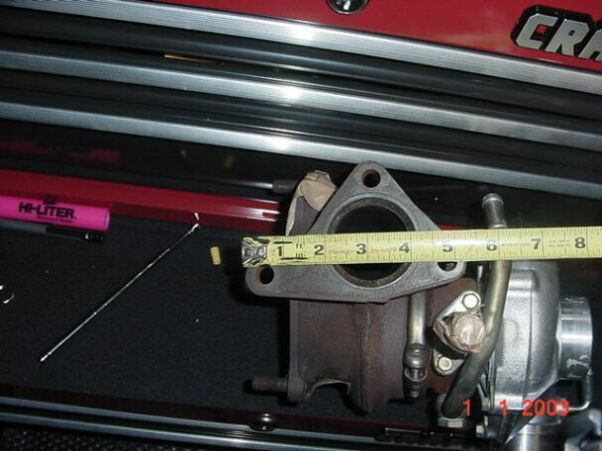

Talking up-pipe feed port size
Richard,
If you still have the vf30 turbo out, how much bigger is the up-pipe feed port in comparison with the stock unit. I would appriciate it if you can take a picture with ruler on it so I can view the difference-

Richard,
thanx-ed
Ed,
The turbo is out, but it's at PCE right now. As soon as I get it back I'll be happy to take a picture/measure the opening for ya!
Aloha,
Richard...

Ed,
Does this help? I thought you were referring to the stock 'uppipe' flange.
Edit: Sorry. Corrected.
Attached Thumbnails Smokin' VF30 Update:-vf30a.jpg
