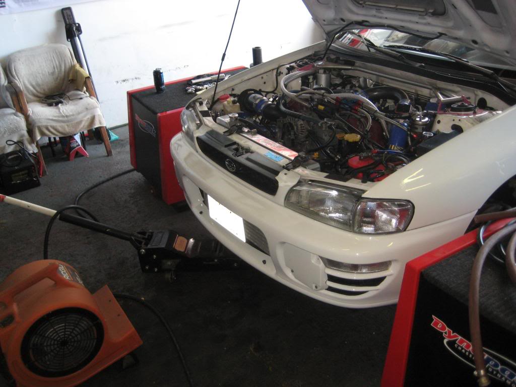

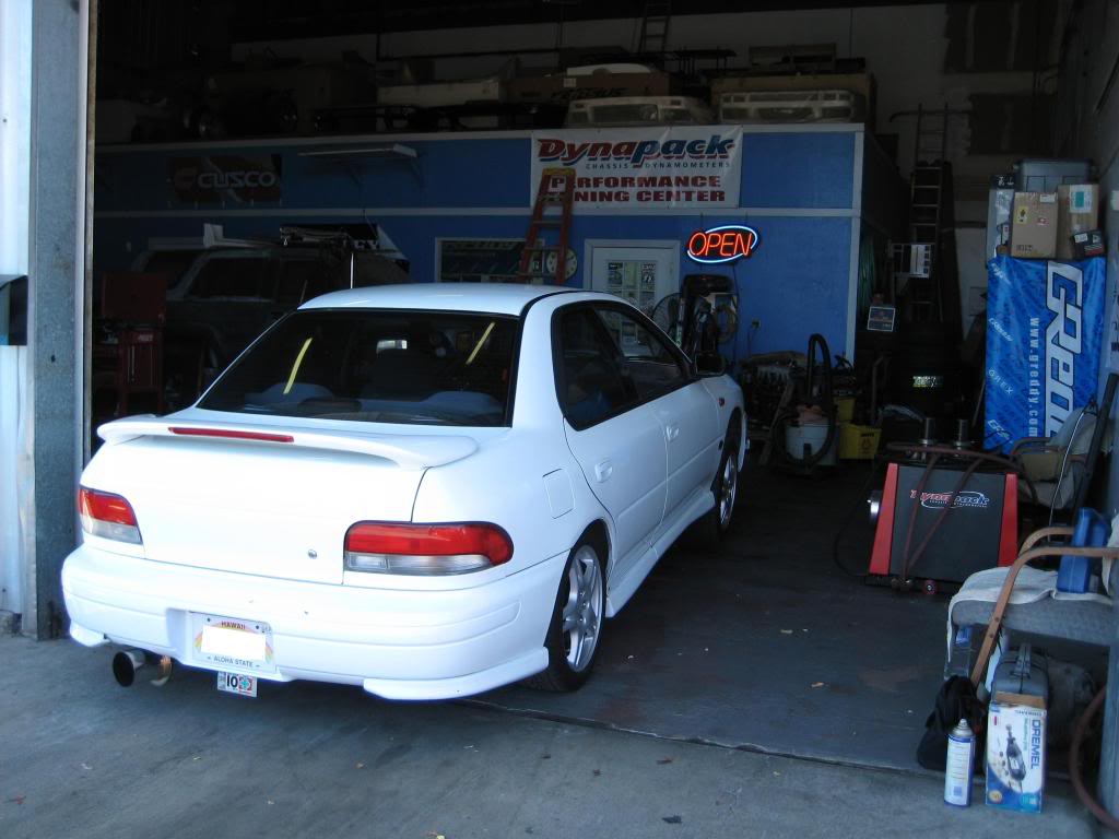

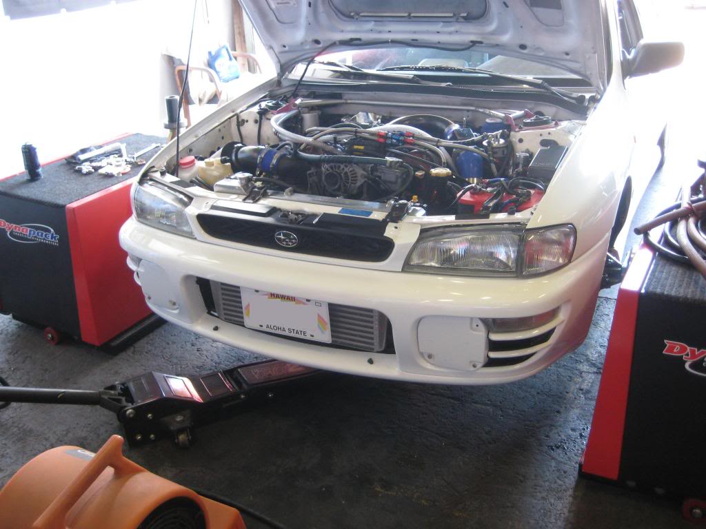

Happy 4th everyone. I finally went to the MunkyWurks' dyno today, on the Dynapack 2WD dynamometer. No tuning, just 4 pulls at 18.5 psi. I didn't want to go 20psi because I didn't want to be stuck there if something went wrong. Anyway, enjoy, here it is!!

the results:
237.9 whp (280 flywheel hp), 235.5 lb/ft tq (279 flywheel lb/ft tq) at 18.5 psi
As you can see it bogs extremely rich at 3500 - 4000rpm. That will be addressed right away by leaning it out a bit, advancing timing, as well as bumping up the boost duty cycle more in some areas.
This is just a baseline run at low boost to see where the power/tq curve is. There's still potential for over 300 flwyheel hp. Next one will be better, more to come.......
