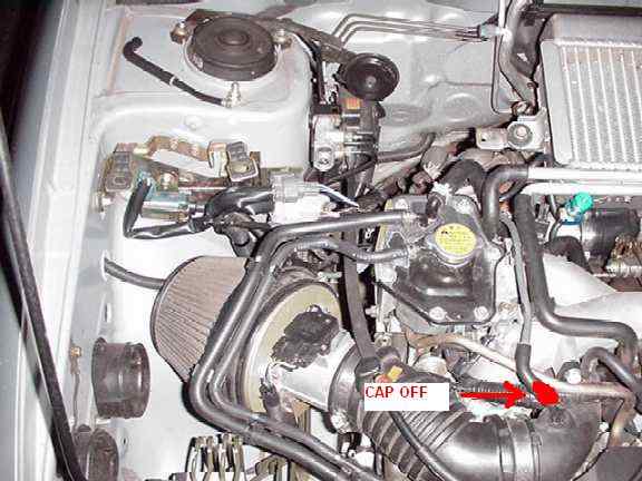

I am pretty sure with all the Blitz ebc's, installation is the same, ... but what Blitz ebc do you have?
- The Blitz soleniod should be connected between the vacuum port on the turbo compressor housing, and the wastegate. I believe the "IN" port on the soleniod connects to the compressor, and the "OUT" port to the wastegate.
- The 'teflon hose' from the Blitz control unit should probably be "T"d into the vacuum hose going to the blow off valve. It is best to buy a "T" and some extra vacuum line to do this.
That is the spot where you'd want to read boost from, for a boost gauge.
You also need to make sure you 'cap' off the connection on the plastic intake pipe (which has a vacuum line running to the stock soleniod, which you don't need).

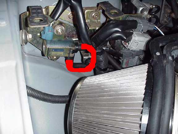

You should also connect a vacuum line, or cap off, the stock soleniod ports. Usually we just connect a vacuum hose to one port and then into the other, esentially inabling it to 'read' anything. Imagine in the pic below that the red line is a vacuum line, that's what you want to do.

cap off the port on intake ...

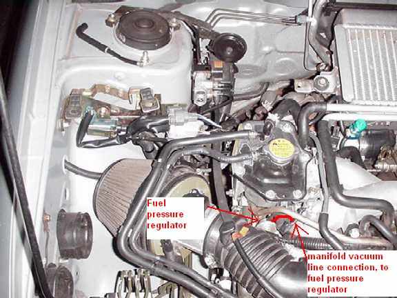

After reading the directions again, I think I'll go back to what I originally thought, ... I believe the "T"d vacuum line that goes to the controller box, should be "T"d in between the Fuel Pressure Regualtor and the manifold. (in pic below, I tried to point to where it should go, the little red line is supposed to be the vacuum line)
and the line from the wastegate should go to the "OUT" port on the soleniod.
and the line from the turbo compressor side should go to the "IN" port on the soleniod.
No 'T' anywhere off of the wastegate.
