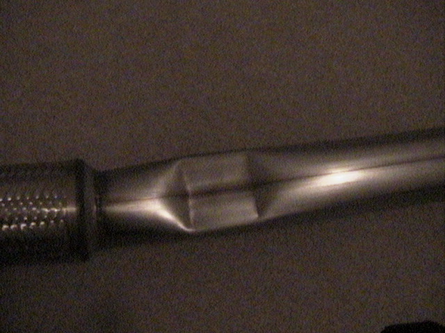

If he buys a Stromung mid pipe from Brian at Flash N Dash and it doesn't work he will be stuck with it since Flash N Dash doesn't do exchanges or returns. When I received my Stromung intermediate pipe I wasn't happy with the design (big turbulent flex joint and a big turbulent dent for clearance) and Brian told me (in a nice way) I would need to sell it if I didn't like it. Brian is very good about answering questions honestly and in a timely fashion but I wont be buying anything from him unless I know the part I'm ordering will work with my setup. If I'm 100% sure the part I'm ordering will work and he has the best price I wouldn't hesitate to buy from him since he is IMO very honest, helpful and good about getting you your part when he says he will.
Here are some pic's of a Stromung intermediate pipe
Attached Thumbnails Look what Santa bought me-102-0220_aut.jpg   Look what Santa bought me-102-0219_aut.jpg

Its an intermediate pipe (the front section of a cat back). When I bought it I thought I was going to get the pipe pictured on your post but Stromung changed the design so I'm stuck with this pipe.
