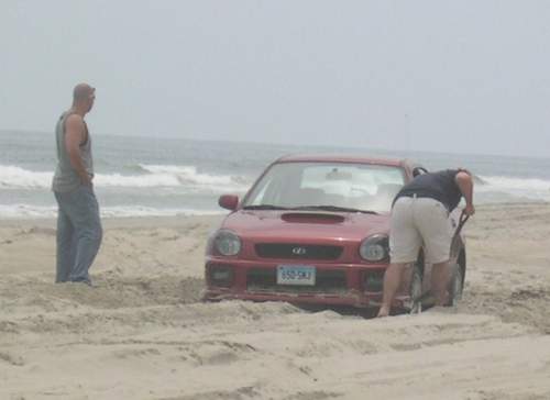

Originally posted by keirnna
I was driving on a beach, just driving, not doing anyting crazy, and my car got stuck.
did it look like this?
Old Nov 19, 2003 | 11:12 PM
keirnna's Avatar
Posts: 2,659
From: Okinawa, Japan
Car Info: 1996 STI V3 Type RA
Quite similar actualy, but the sand was not so deep, and I was only about 30 feet into where I later found out the road ended. Could someone please suggest an aftermarket clutch/ flywheel that I should get.
