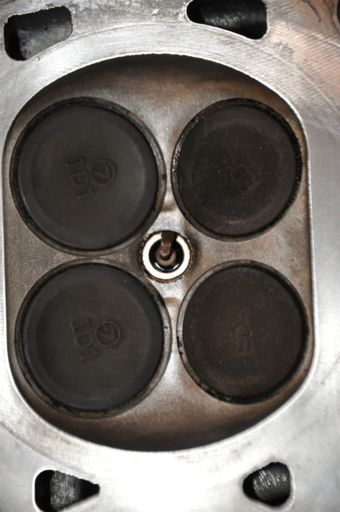

2.0 head after a little dremel work, not completed
bad angle on the 2nd picture, but trust me....it's almost the same

it isnt cleaned or polished yet in that picture,but you can see the general idea...looks 95% the same as the professional CNC job. the curve just isnt as perfectly smooth.

Yeah there really is no comparison.
the pics speak for themselves.
EQ tuning heads:
VS:
yeah, the prices arent the same, but in this case i guess you get what you pay for.

It doesnt look as pretty, but as far as performance, is it really worth all that money for the probable and likely 5hp gain over a dremel job?
If money is not an issue, sure go for the CNC job. It is better no doubt.
Dremel work it isnt a job for the artistically challenged, but if you can draw or sculpt it's kinda the same idea. It is just recreating what you see or invision.

i think the peace of mind knowing you have consistent compression ratios across the board speaks volumes for the CNC job. not to mention the proper quench, and combustion volumes. oh and having even pressures on the headgasket in each cylinder is nice too. so yeah.
taking a dremmel to your heads is about as redneck / ghetto as you can get.

but i bet there is less than .25cc variation between all the cylinders. Changing one of your spark plugs to one 3mm longer will make a bigger difference.
I have personally assembled over 100 engines, no, i wouldnt eyeball it and guess on bearing clerances, head bolt torque, or gear lash. but this is one area that it really makes a very minor difference.
the subaru ecu is very intuitive and addaptive, I doubt it minds the .25cc difference.
for example, if you blow a headgasket and machine just one head like .012 inch. it will learn it and run just fine.
