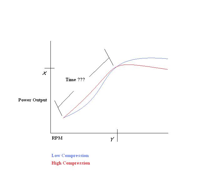

What I am talking about is the measuremenat of time between 1000rpm, and x amount of power at y rpm.
Keep in mind that the intention of this scenario isn't to get the max high rpm power or take the components to their breaking point.
Lets keep y at a low number like 5k
using the same stroke and bore.
8:1 boosting 14psi vs. 10:1 boosting 7 psi
Keeping target egt the same, and less timing advance for the higher compression up top.
Vague hp curve:
Are you saying that there is no time difference between 1000 rpm and the point where x and Y meet on the chart?
Trafic light to trafic light the lower compression guy is screwed.
Where the blue line dips (berween 1k and 5k), that is lost time between point a and b on the road.
Then, past a certian point, the ability to run higher boost and more advanced timing will come into play and win the race on the freeway.
Vague hp curve:
You've just explained that the curve changes from more torque.
You're referring to area under curve.
That should be improved per pound of boost. Spool would not change.I don't see how that's different from what I stated earlier.
I'm not sure I understand your new point about timing

I understand what you are talking about though. I see that higher compression results in more complete burn and higher egt. Thus creating the need to decrease ignition timing or add fuel to keep the burn cooler to maintain target egt. I'm not arguing the point of mechanical knock threashhold.
Higher compression equals more power per lb of boost (you said it yourself)
At high compression or low compression engine (at sea level) is already over 14 psi...without a turbo. This being said, a higher compression engine outputs more power per cc.
We just have to know the mechanical limit of out internals and keep that fu(king knock away.
