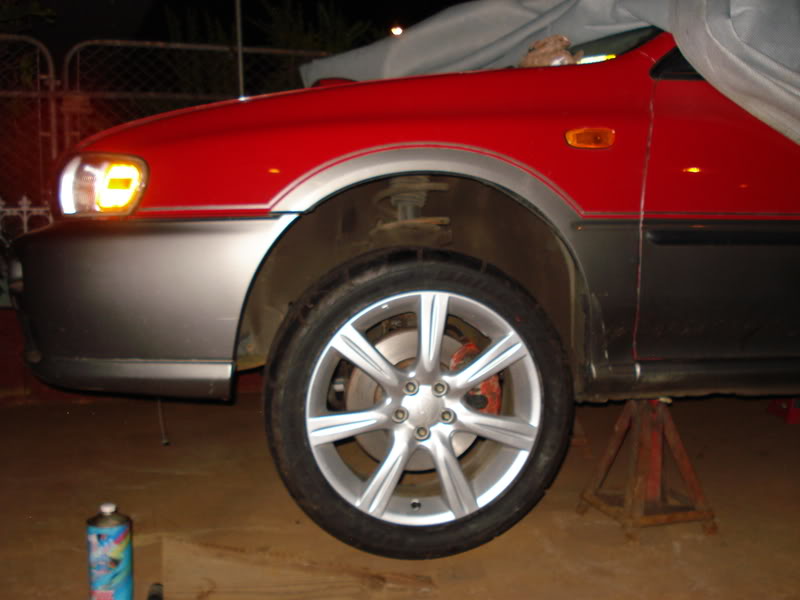

Sneak Peek @ the WRX TR rims on the wagon
I think I will keep the wheel gap
NOT!

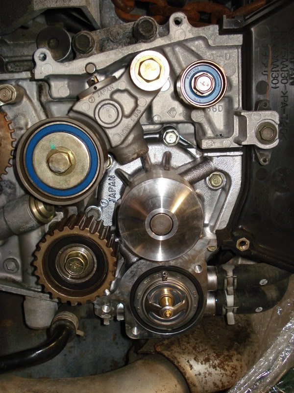

Water Pump Install
Here's a pic of the block with old water pump removed:
New water pump:
New water pump installed on the block:
The water pump was a straight forward swap I think it was only easy because I have the engine out. With the engine installed I can see where it can get really tight especially when re-installing the timing belt.

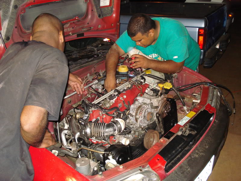

Timing belt install
Here is Dave installing the timing belt:
Timing belt in............. FINALLY!

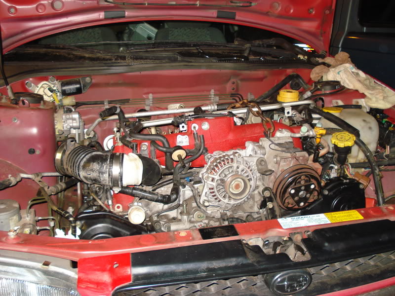

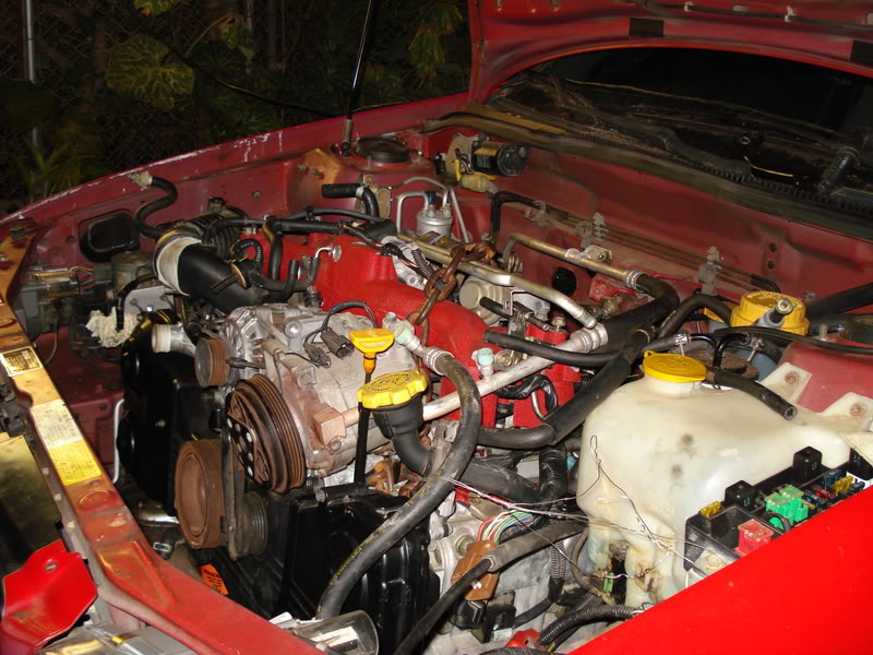

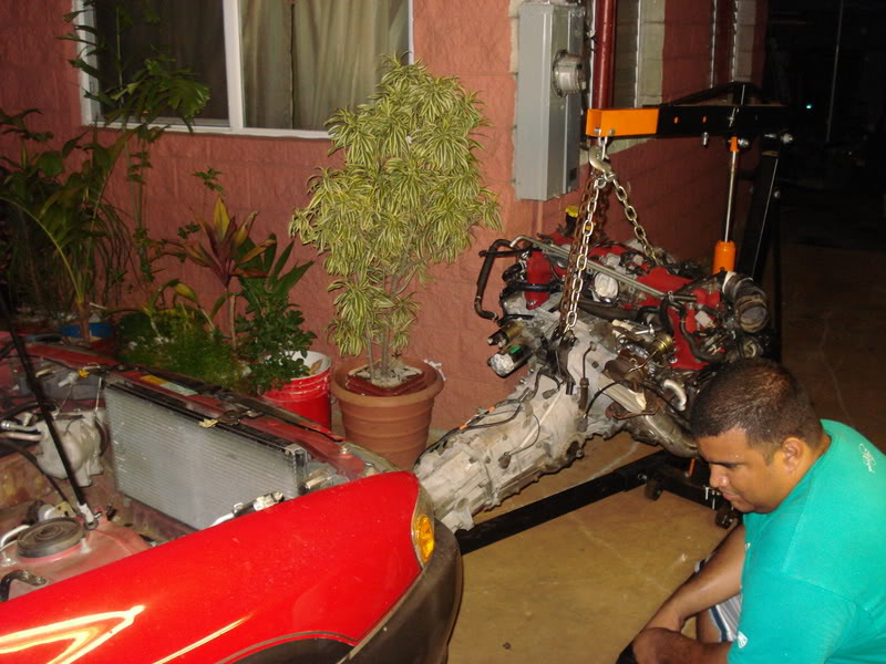

drop the motor and tranny in tonight...........here are some pics....enjoy
