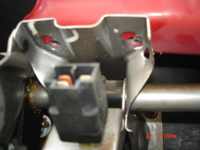

I swapped out the pedal set today. It was fairly straight forward with the exception of slightly drilling out the top holes of the pedal set as you can see from the first pic. The rest was cake. It's amazing how a car that is stock a cable clutch and already has the hole and mounting area for a hydraulic clutch.

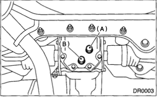

I think I have the support diff studs and nuts that support the diff onto the rear subframe
I believe subaru uses at LEAST and 8 grade stud there.
If I find them you can have them.
Jon

yup those are the studs with the nut on them. see jess i told ya to keep them the same but if it helps the bolts he got where SS bolts
jon in the pic you posted that bolt looks like it is the same size that jess has at home but the nut is ceised(sp?) on and thats what made the stud too short
Old Jul 2, 2008 | 12:06 PM
iNfEk's Avatar
Posts: 10,455
how do you mean it's to short? and how'd you guys put the diff in? in order for you to properly fit the rear cross member with the diff you have to also drop the rear sub frame area which interlocks with the diff and the rear cross member before you can put it up.
I would use the correct things especially for critical pieces.
you don't want the bolt to long since it could damage the diff housing. It's not threaded all the way through.
Jon
