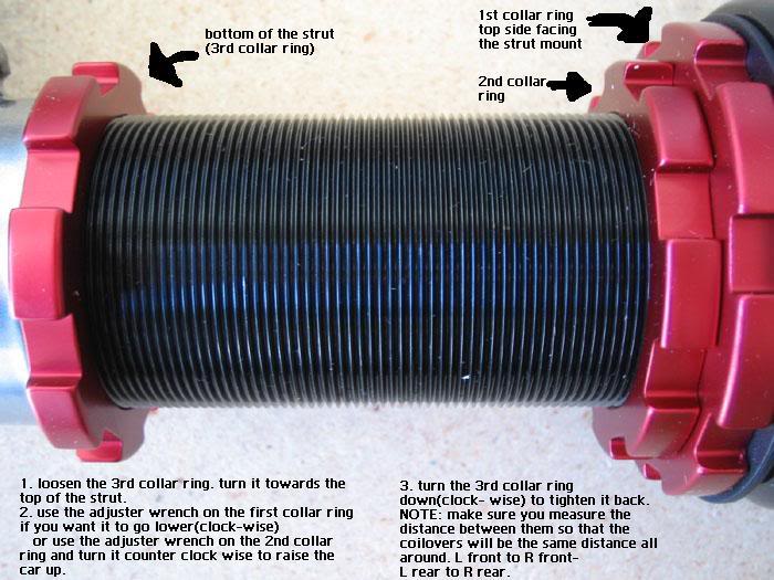

well usually what i do is loosen the lower locking collar at the very bottom, then i use the adjuster wrench on the top locking ring while its still locked and turn it to the direction you want. hope this helps.

here hope this helps. did the best i could to explain.

thanks guys! yeah tried that but the strut wont budge. hoping letting the pb blaster marinate for a day will help some.
