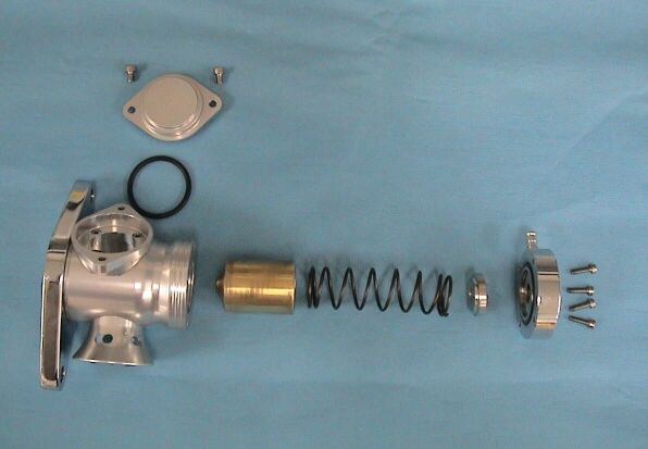

The piston that rides up and down inside of the BOV may need lubricating. It may be sticking to the inside of the body of the BOV. I had this problem with my GFB and took it apart and took this pic. Open up the BOV and disassemble everything. Wipe out the inside with isopropyl alcohol as well as the piston. Re-lube the outside of the piston(brass portion in pic) with silicone grease and put everything back together.

This was my exact problem when I had my GFB. And the re-lubricating solved the idle problem. Another thing you can check as well:
With the car running at idle, open up the hood and get some carb cleaner. Spray car cleaner around the circumference of the BOV on the intercooler. If the idle goes up at all when you are spraying, you have a gasket leak. You will need to replace the BOV gasket. Try it. It is worth a shot. If that doesn't help, re-lubricate the BOV and try again. If all else fails, get rid of the F'ing BOV's and go back to stock. Nothing better than 100% recirculation anyways.

Ok, so for right now I've given up with the RFL, and I'm concentrating on the GFB... I tried changing the block off piece that covers the recirculating hose, I cleaned out the GFB BOV and regreased it with silicone grease and even got a new IC gasket. As far as I can see, there is no leak/crack in the vacuum hose. Ahhhh, what now!
