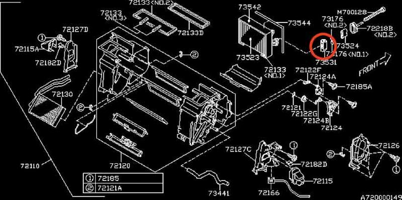

Old Jan 8, 2008 | 12:26 PM
iNfEk's Avatar
Posts: 10,455
actually... see the attached photo... this is where it's located in the car. If you want to get to it you'll be removing the entire dash and everything after that to remove the heater assembly in the center of the car.
Attached Thumbnails A/C Expansion Valve-img_2536.jpg   A/C Expansion Valve-i720-101.jpg
