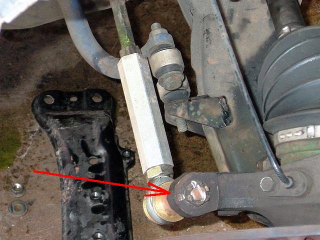

Originally Posted by bpang1
Yeah I'm gonna go rent the tie rod end push out clamp thingamabob from autozone beforehand...apparently some people try to pry it out and ruin the boot.
you don't need one of those seriuosly.
All I did was take the cotter pin off and loosen the castle nut until its covering the top of the tie rod end threads (almost flush to the top of the TRE)
Get a mini sledge hammer or similar weight hammer and bang against the wheel hub connection area so that there is vibration through the TRE. do not hit the castle nut. eventually the TRE will fall being held by the castle nut and you just unscrew it. Sounds scary but really not
Jon
Attached Thumbnails BJE install...check here later to see how much blood is spilled.-picture-52.jpg
Old Jul 3, 2008 | 12:20 PM
houdni's Avatar
Posts: 1,129
From: K@ilu@, H@w@ii
Car Info: 06 STi
looks kinda like a bump steer kit....though it would be better if the tie rods were height adjustable...
the six guns versions (the ones that I have) do correct bump steer. I posted a picture of the actual TRE in the first page
