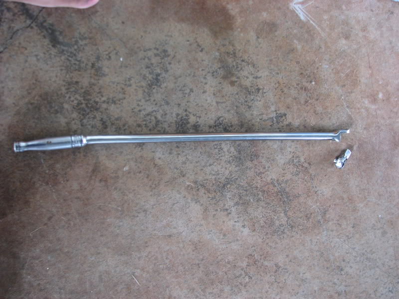

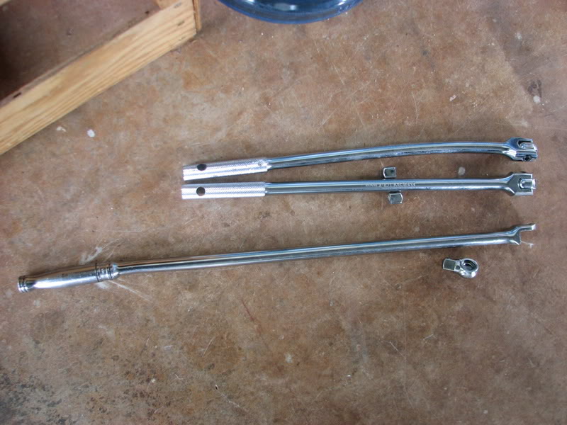

update!!! axle nut +10000000 me -10000000000000000000
btw this last breaker bar was a SNAP ON 24"

i'll come help you tonight at your house. i was going to go to the meet but you snapping breaker bars isn't good
i think you're bouncing on the bar causing these to snap.

Break it in half already...you're replacing it all anyways right?
Plasma torch and take a video!!!!!
Old Jan 25, 2008 | 04:09 PM
  #39
Tiare's Avatar
Posts: 2,841
Wow, so how many bars did you eat? damn... now I name you the Breaker Bar!!!
