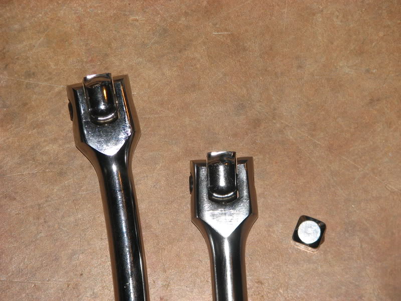

hahahaha there junk but still it shouldn't break like butter

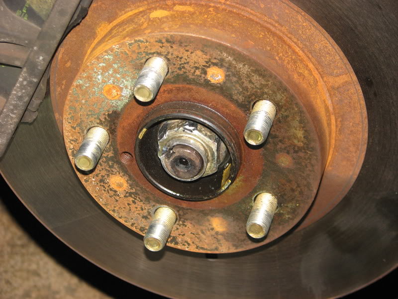

from bottom up
these are back wards but still i lost!

wow that nut is getting shredded...looks like there's a notch or something that you have to bend out...anyway LMK if you need the impact gun, I also have a Snap On breaker bar, if it bends or breaks the Snap on guy replaces it for free..GL

I wonder if a dremel cutting disk can get in there?

yeh i bent it all out........and if i ned to dremel i will take off the rotor and brakes to get a better cutting angle
