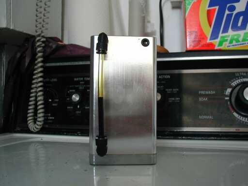

and heres what it looked like after a few weeks, the oil in there wasnt too bad, but after i emptied it, and it refilled again in a few weeks, it looked like hot mustard, and it smelled like poop.
how do you empty it...and btw do you have to refill it after cleaning it(i didn't even know that)...sorry stupid question...
that is a greddy CC, there are 2 ways to empty it, remove the 4 allen bolts on the top, and pour out, or remove one end of the tubing from the connector and let gravity drain it out.
and i belive you misread what i wrote, or i worded it wrong, you dont refill it with anything, it refilled it self with blow-by, all by itself
doh rudy, damn i feel stupid hahahah...thanks though i appreciate it...and one more question coming your way through pm..thanks..
