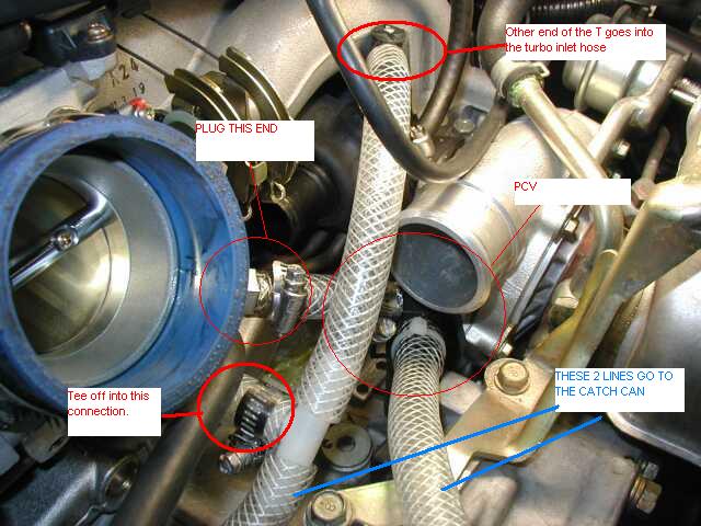

Jeff since you have my old stage 4 heres how I installed the catch can.
