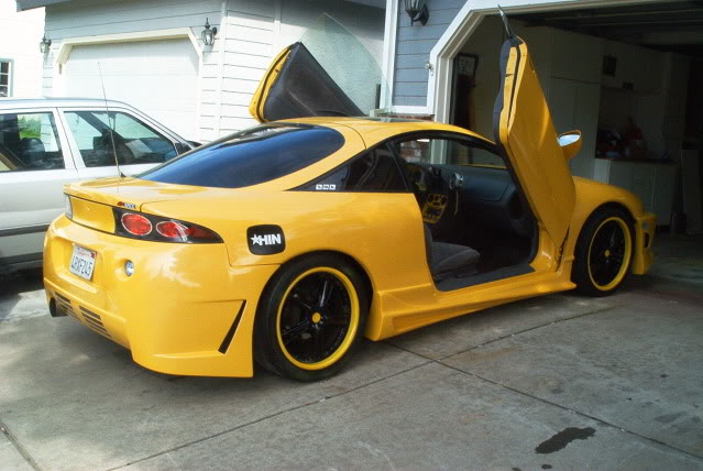

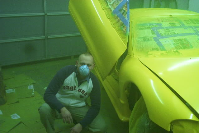

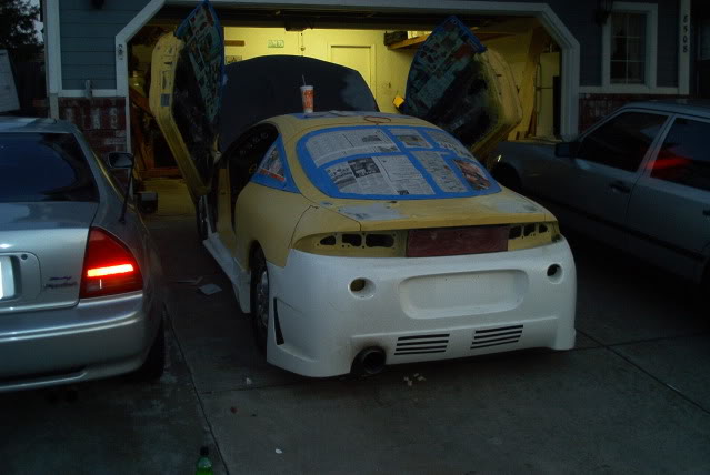

PAINTING CARS IS FUN (helping my friend, btw...he drives 03 WRX now)
