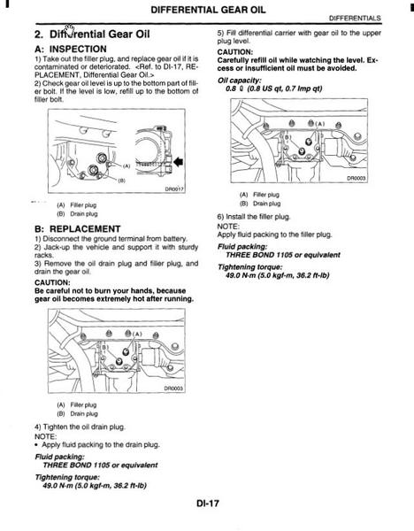

straight from the service manual...
Thanks, but, that would only work if I had a way to lift the entire car, and I don't

I have not done this yet, but I dont think you need to jack the front of the car.
The instructions I've read always say lift full car, meaning the car is level when it drains, so I think you can skip the front lift, just lift, unplug, lower, drain, lift, refill.
