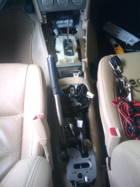

You dont want to end up like this....

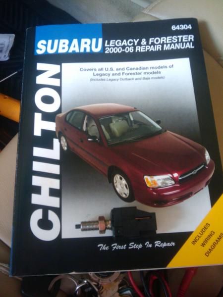

For nothing.
Its easy to check. Have someone watch your breaklights to see if they come on. If they don't. Than thats the problem. And an easier fix than taking everything apart. Well hope my problem and fix comes in handy for anyone who has the same problem.

Thanks. Just thought i'd save everybody the time and hassel of wht happened to me. And yah I hate when people ask and don't follow up. Anyway forgot to take a pic of the foot pedal under the dash. So people can see what I'm talking about. Well hope this helps someone and saves the time. If this helps you please let me know and post something back.
