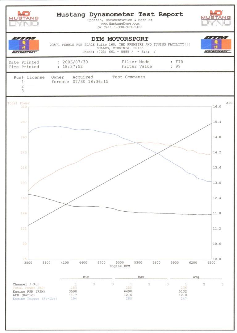

Well, had a custom PDX map sent to me about 10K miles ago. I noticed my plugs were a little white when I changed them at 50K...I have 55K now, BTW. This first graph is w/ the first custom tune (They have since sent me one w/ +.3 more fuel which I need to get another dyno graph w/ A/F done again):
My mods are:
'04 STi ECU
'04 STi COBB AP
VF39
Helix TMIC
Helix 3" Catted Downpipe
Daddy's Maddad 3" SS intermediate pipe w/ flex joint
'05 OEM STi axleback
(All this w/ my stock XT 4.44 gearing!)
Here is the run. Notice it is a bit lean and the power up top is still lacking but will get remedied. Also, just for reference my buddies '06 STi w/ only a TXS shorty intake did 245WHP and 239ft/lbs on the same dyno right before me:
