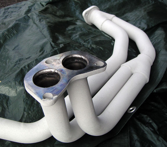

I just received my Borla header today back from Swain Tech. I sent it in to have their "Thermal Barrier Coating" applied which is a .015" thick sprayed on thermal shield. This coating is supposed to reduce radiant heat by 50% and effectively lower underhood temperatures. After I installed it, I "Darwin Tested" it to see if their claims were true about being able to touch it at operating temperature... After coming back from a drive and with the car still running, I tapped it with my bare hand, then brushed across it and finally briefly grasped it for a split second without getting burned. You can barely feel heat coming from the header if you hold your hand close. Pretty impressive.. I read about this in Grassroots Motorsports. I took some pics before putting it on, please excuse the bad lighting as I couldn't wait for it to improve. Just wanted to get it installed..
The total cost for the process was $185 plus shipping there ($25) and their shipping/handling fee for the return shipment was $86.69 (from NY to HI). It was shipped to them on 6/23 and I received it back today - 7/25.
Attached Thumbnails For those that asked about it: SwainTech Header Coating pics...-borla.4.jpg   For those that asked about it: SwainTech Header Coating pics...-borla.3.jpg   For those that asked about it: SwainTech Header Coating pics...-borla.flange.1.jpg   For those that asked about it: SwainTech Header Coating pics...-borla.flange.2.jpg

Two more pics to show the coating thickness and such..
Attached Thumbnails For those that asked about it: SwainTech Header Coating pics...-borla.flange.close.edge.jpg   For those that asked about it: SwainTech Header Coating pics...-borla.weld.detail.jpg

Installed... The header seriously turns up the boxer tone and is much louder overall. I am hoping it won't be too deafening with the cats gone + midpipe with the ScoobySport axleback, but from the sounds of it - it will be.. The only issue I had with the install was somehow one of the header-cat pipe bolts was x-threaded and snapped after the 3rd turn. Everything else was pie. I torqued down the header-head bolts to 22ft/lb and will re-check them in 500 miles.
NOTE: The header is a Borla but the flanges have been re-welded by a fabricator I know since they looked a little flimsy.
Attached Thumbnails For those that asked about it: SwainTech Header Coating pics...-header.cat.bolt.jpg   For those that asked about it: SwainTech Header Coating pics...-borla.installed.jpg

looks great, I was never impressed with Jet-Hot and have seen some real good pieces from Swain

Thanks! They have an amazing variety of coatings for pretty much everything from internal engine parts to brake calipers (two coatings, the outside is a 'heat extracting' finish and the inside is a heat barrier to protect the pads and such). If I had a money tree in my back yard, I would have them coat just about everything. This header coating is awesome so far...
