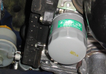

Here's a pick of it fitting perfectly on the car

...and lastly are you ready for this the installed Mobil 1! Thank the Gods!!!
