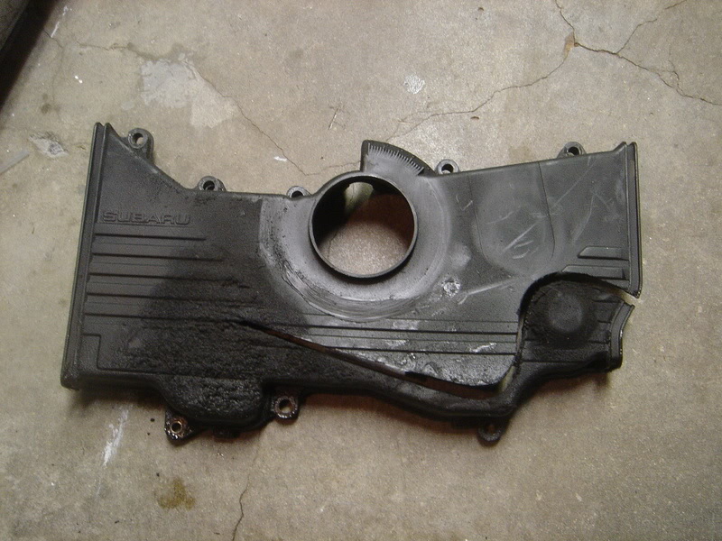

WHAT CAN I DO???? Do I have to replace the entire crank? Do I get creative with JB weld??

JB weld does not hold very well under extreme pressure. I haven't found JB weld to be good for much. By the looks of it, I can't see why you couldn't have a fill weld done and carve out your keyway with a die grinder. Other wise you might as well look into a new short block. Same price more or less.

go to a junkyard and find a 2.2 out of an older legacy...it would be suPER easy to swap in..with almost no modification! PM me for exact details

I agree, doin a swap would be much easier that tearin down your motor.... you could do it in a day, easy.
