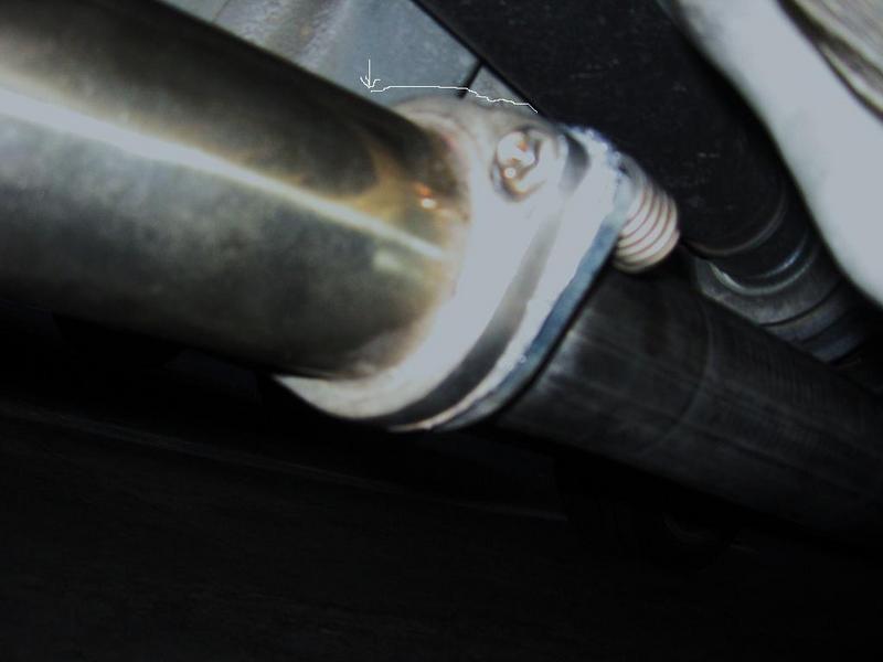

ok i have the helix catted downpipe and the bosal cat back. when i put it on i noticed a couple of leaks. then i noticed that the downpipe is hitting somepeice of metal right before it connects to the cat back.
now i fixed 1 of the leaks and spent all day today trying to fix the second leak. i tried different hardware i tried using two gaskets but nothing is working if anything i mad it worse. what is leaking now is where it connects to the downpipe ontop of the flange there is a gap that i cant close it is like the donwpipe has a little bit of an upgrade so only the bottom gets a really good tight conection. what do i do. someone help my dumbass

Disconnect the axel back and try to connect the midpipe to the downpipe. It should align a bit better. I had to cut one side of my stock hangers to make my pipes fit without leaks.

where the white line is the exhaust leak is the arrow just means its it goes around almost to the other bolt

You should realign your exhaust agian. Don't double gasket your just wasting your money, and it will still leak.

Exhaust doesn't look lined up at all. I ditched the spring bolts also.

its not the downpipe its the catback thats not right. i have used this downpipe with a different exhaust and it worked perfect. just doesnt sit right with the bosal. plus i have a catless in the garage that im goin to use. screw catted i love catless
