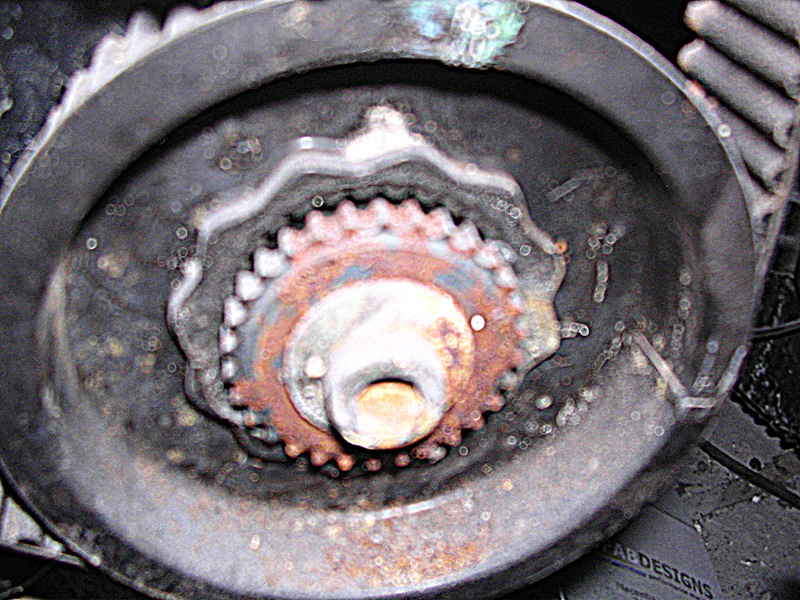

I am thinking about purchasing a used 04 STI engine that is still (from what I gather on the phone) in good shape with the exception that the car was in a front end collision.
according to the guy the timing belt cover and exhaust cam sproket was damaged due to the impact.

I would not buy an engine with broket cam sprockets. There is a potential head damage as well if the cam was physically pushed back. Even a bit.

well this is all that I can afford right now and cannot move forward in my project unless I do this.
is there a way that I can tell what is damaged? I'll post picture when I get them.

The STI has shimless heads. If the camsprocket is broken, you can bet there are bent valves. The heads will need to be machined, the sodium filld valves on the STi are not cheap, new cam gears, timing belt, covers, headbolts or ARP studs, gaskets up the ***......The head work performed......It could run a grand to fix it.

it's from the neighbor island... I've got a blurry picture of what is broken.
the gear looks like it got pushed back off of the cam shaft.
I still have to sort out some issues with this guy since the pictures he showed me didn't have an intake manifold... I'm hoping the shop that was working on it just took it off.
