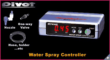

save yourself the trouble and get this
http://www.intakeone.com/Pivot/Piv_WSC.html
or this
Attached Thumbnails Intercooler Sprayer-index_wsc_big.gif   Intercooler Sprayer-rotorworks_1816_641053.jpg
