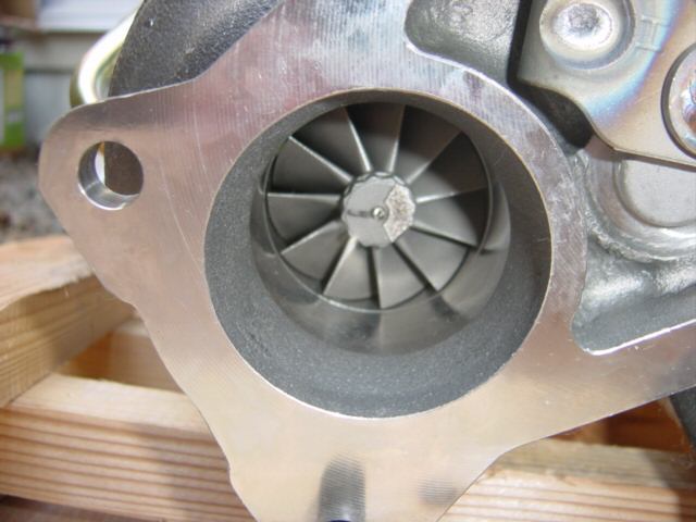

Found a little bit of info and some pictures......
IHI VF37 twin scroll ; (206Kw 280ps/600rpm, 394N.m 40.2kgm/ 4400rpm according to the Subaru JP web but not really what I was looking for.
Attached Thumbnails IHI VF37 turbo TWIN SCROLL design specifications?-73_3.jpg

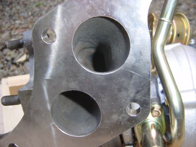

Attached Thumbnails IHI VF37 turbo TWIN SCROLL design specifications?-44_3.jpg

Originally posted by Mach5WRX
Last one......the more I read the more I find this my not be a good turbo for the 2.5L
No, it's definitely a bit small for it. Great for an EJ20 or EJ22T though.

Old Aug 2, 2004 | 07:19 PM
Mister 2's Avatar
Posts: 1,224
From: Honolulu, HI
Car Info: 1991 Toyota MR-2 Turbo
I love how that exhaust housing is designed (2nd picture). Notice how the turbine and wastegate flow are completely seperated. Just add a HKS downpipe with a dump tube welded on and it'll sound like an external wastegate setup
