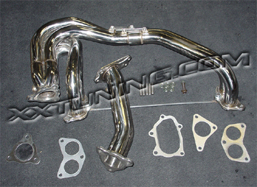

I have the XXTuning Header (same as GT Spec II)
one side is about 3/4 the length of the other...not an equal length header but closer than most...it changed the sound of my exhaust dramatically...It still has a little of the Subaru rumble, but gone is the Harley Chop...I'm sure the equal length will get rid of even this...
I can't get back the low/deep sounding exhaust sound with the header...

If you look closely, you can see that it is not equal length...
