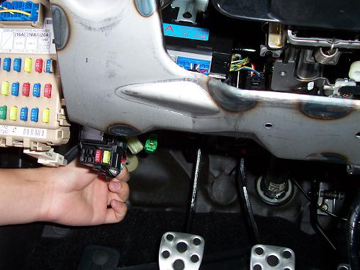

Hey guys, i was cleaning my car when i saw a little peace of blue tape hanging from the panel under the stering wheel. When i looked under i found the ends of 3 wires, is this normal? can someone go out to their car and take a peek? u don't have to take off the panel, i just did so i can take pics of them. THANX! (driving a 05 WRX) heres some pics of them

The two green ones are for engine diagnostics, etc. and should be left unplugged. I don't know what the third one is for. If you do a search on this topic I think you will find that this was discussed not too long ago.

What you see is normal so leave it unplugged. When I flash a base map with my accessport I have to plug the 2 green plugs (test mode connectors) together and I have to plug an initialization connector to the semi clear (whitish) connector. After the flash is done I disconnect everything and it looks just like your pic.
