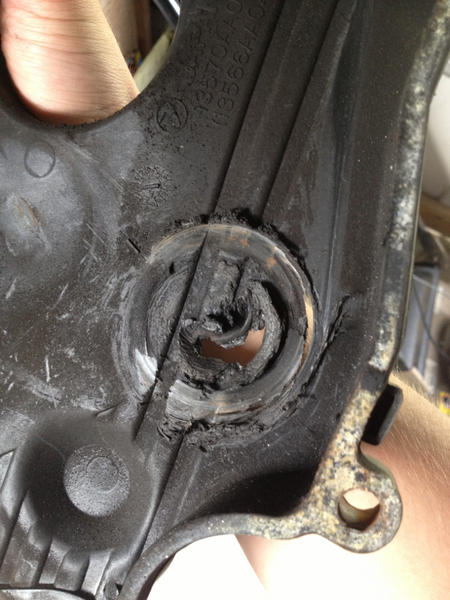

Sorry I haven't replied to this one but I took the cover off and the guy must of revved it too hard and blew the idler gear .. Sent metal right through the plastics . Lets hope he didn't bend any of the heads .. And man I'm only 15 and can't even drive it yet , I think I'm pretty knowledgable for my age for purchasing a great car like this #bugeyemafia

+1. i agree heng. this is how i club drama starts. whats tyhe point of these forums if no ones going to help. theres a diff between this OP and "waist gate" thread. know the difference.
OP, ya i honestly would tear down your entire shortblock after a problem with timing belt. i honestly dont remember if we have intereferancve or non intereferance. but its a good idea if u have high mileage as well, to do a full rebuild. GL! keep this thead update. As a gearhead myslf, post up a pic of that shattered idler! i wanna see this. lol

Here are the plastics that metal grinded and shot through , we through the gear away..
http://m1360.photobucket.com/profile/johnny02wrx
